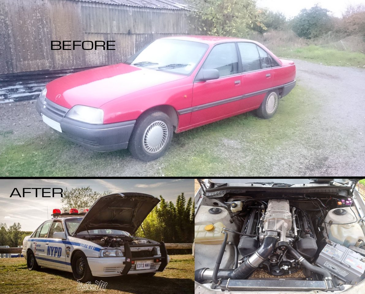

My name is John and I live in the UK. I've had a passion for the Vauxhall Carlton mk3 (Omega-A) for perhaps 20 years and have owned many. I was put on to this forum by Martin (viewtopic.php?f=39&t=14973) as I wish to buy a EVO500/DTM bodykit off him when they are ready.

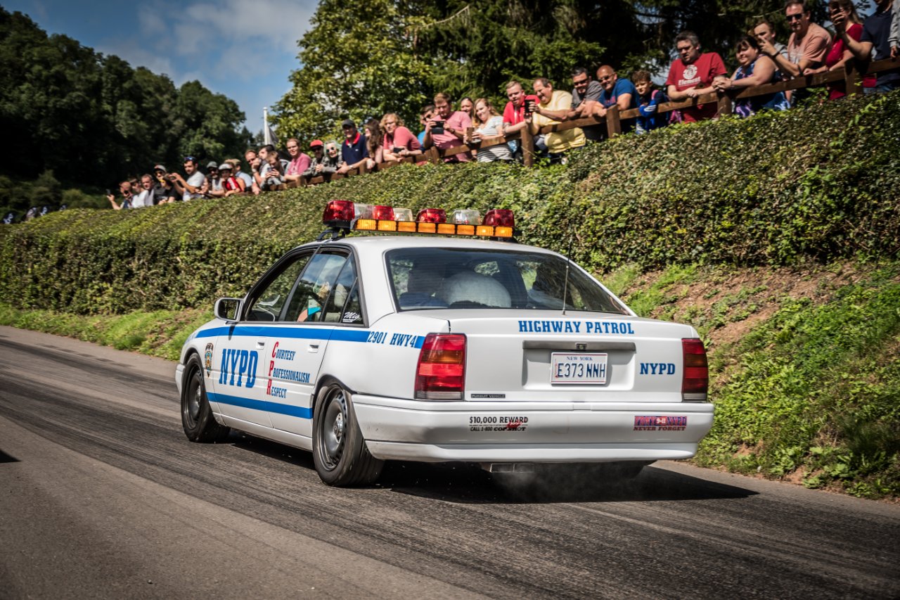

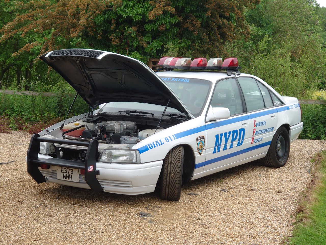

Here is my Carlton currently:
Before after.jpg (286.45 KiB) Vaadatud 16937 korda

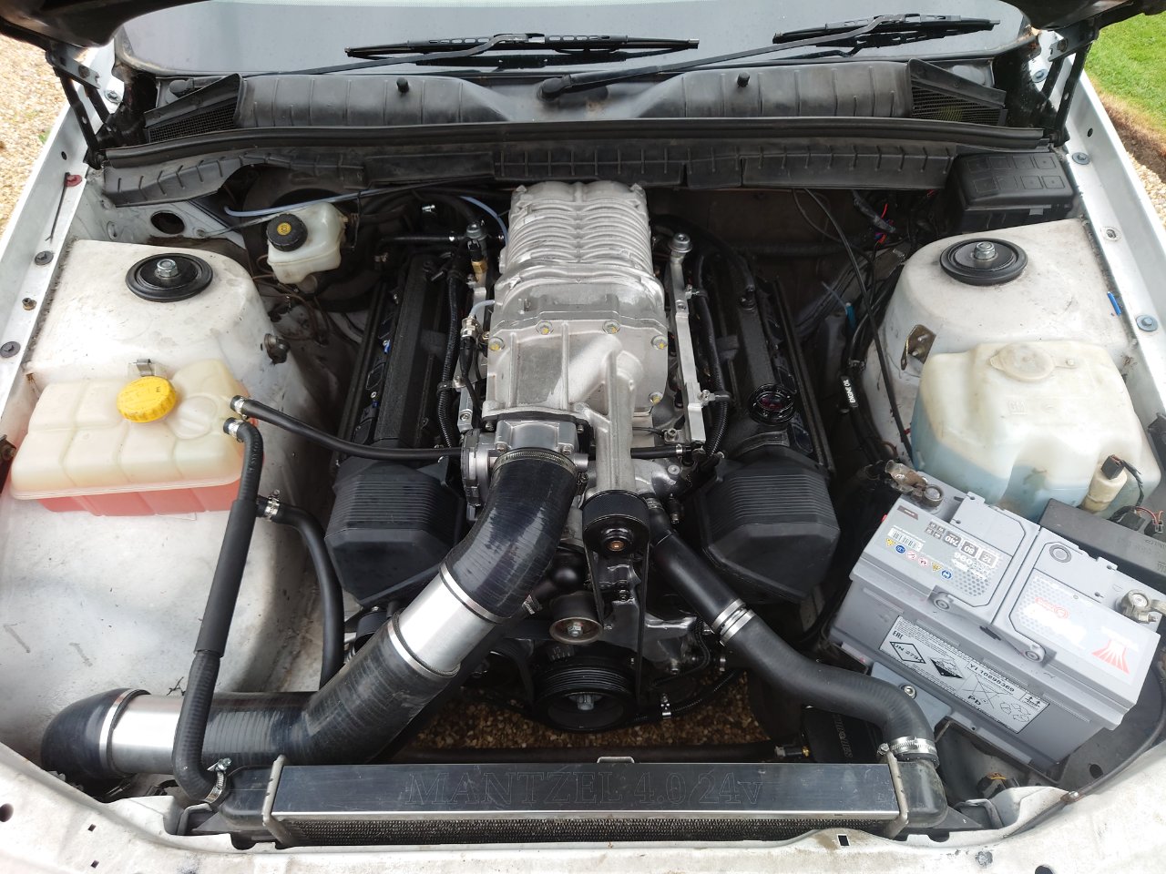

1UZFE 4.0 V8 from a Lexus LS400.
Eaton TVS1900 Supercharger
MaxxECU Race management system
405 rear wheel hp
Omega-B 2.2DTi manual gearbox
Vauxhall Monaro VXR rear differential

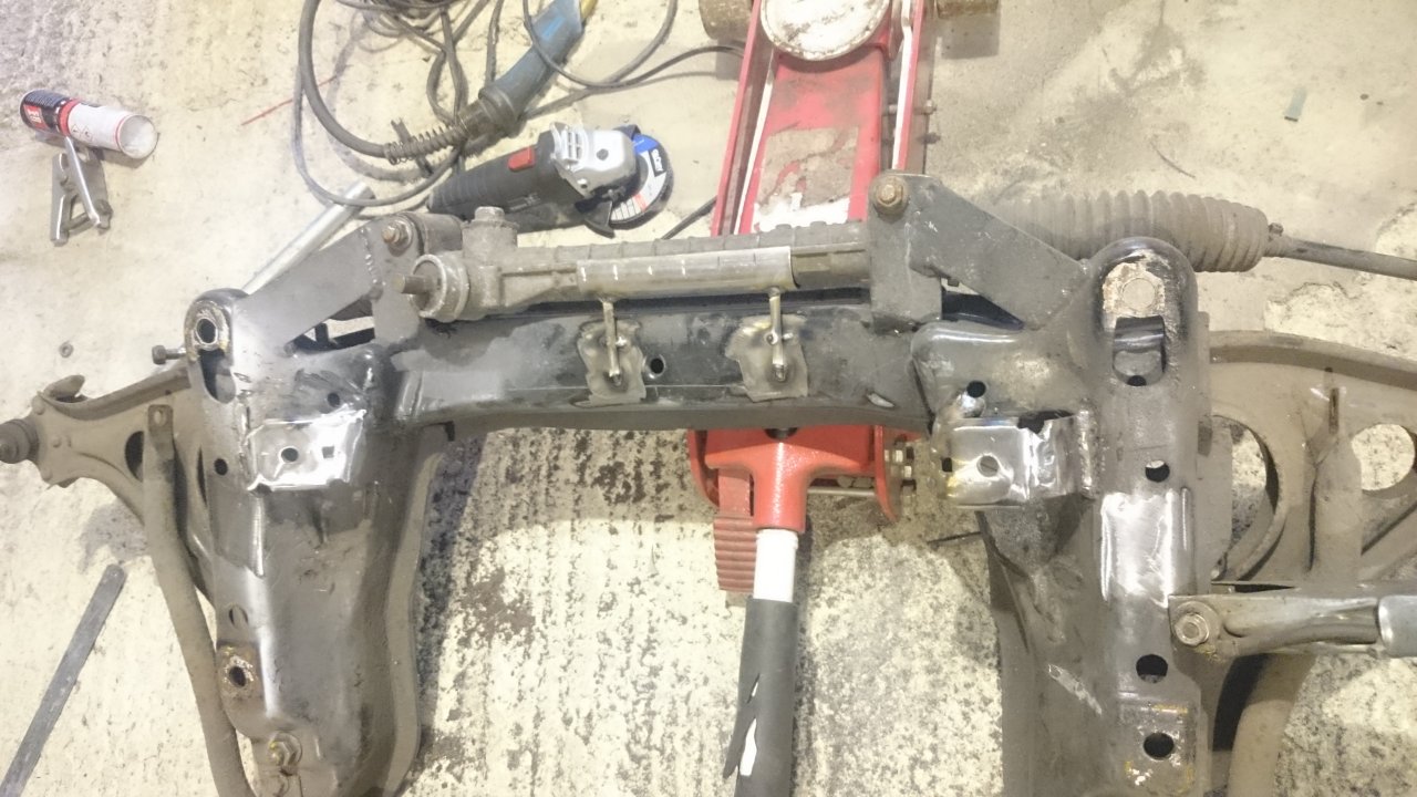

Steering box replaced with a rack and pinion steering system from a Corsa-C

What car steering rack did you use?

risto002 kirjutas: 31 Jaan 2024 09:51 What car steering rack did you use?
Corsa-C. I used the steering rack and the electric column.
I did have to modify the tie rods and used Vectra-B ends

Does it have senator headlights?
Front end seems bit strange with them.
OT. Few days ago one guy from norway installed right hand BMW e39 steering rack reversed to left hand drive omega A.
Did you calculate your setup or just trow steering rack into there?

Martin kirjutas: 31 Jaan 2024 13:53 Does it have senator headlights?
Yes, Senator B front end. I fitted it to be more suitable for the American cop car look.
When I convert it to a DTM replica I will refit the Carlton front end.
Martin kirjutas: 31 Jaan 2024 13:53 OT. Few days ago one guy from norway installed right hand BMW e39 steering rack reversed to left hand drive omega A.
I calculated it, the rack pivot points perfectly match the original pivot points so there is no problems with geometry. This is why I used the Corsa C rack, it's length is almost perfect to match the original Carlton.

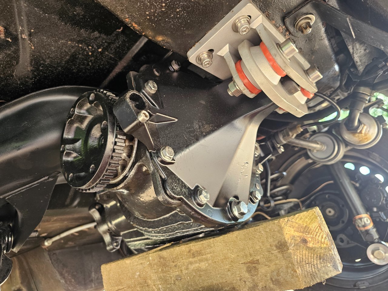

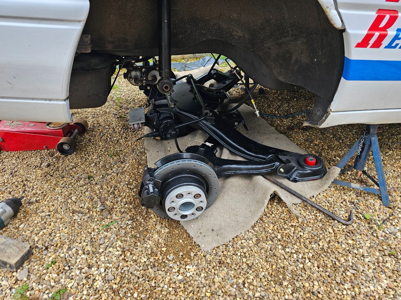

Refurbished rear axle going in
Postitusi: 2842
Re: UK Vauxhall Carlton 1uzfe supercharged
rear diff cover is custom made?

Martin kirjutas: 09 Mai 2024 16:43 rear diff cover is custom made?
Do you mean the rear diff mount? No, it's a Holden HSV tuning part from Australia
